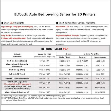

Dal link dei comandi Marlin che ti ho girato, dovresti trovare come lanciare il G29 con le varie opzioni. Ad ogni modo, il comportamento di "default" per la tua stampante e' impostato nel firmware e quindi dipende da come e' stato compilato. Qui di seguito trovi come ho compilato il mio e come ho impostato il comportamento di "default" //=========================================================================== //=============================== Bed Leveling ============================== //=========================================================================== // @section calibrate /** * Choose one of the options below to enable G29 Bed Leveling. The parameters * and behavior of G29 will change depending on your selection. * * If using a Probe for Z Homing, enable Z_SAFE_HOMING also! * * - AUTO_BED_LEVELING_3POINT * Probe 3 arbitrary points on the bed (that aren't collinear) * You specify the XY coordinates of all 3 points. * The result is a single tilted plane. Best for a flat bed. * * - AUTO_BED_LEVELING_LINEAR * Probe several points in a grid. * You specify the rectangle and the density of sample points. * The result is a single tilted plane. Best for a flat bed. * * - AUTO_BED_LEVELING_BILINEAR * Probe several points in a grid. * You specify the rectangle and the density of sample points. * The result is a mesh, best for large or uneven beds. * * - AUTO_BED_LEVELING_UBL (Unified Bed Leveling) * A comprehensive bed leveling system combining the features and benefits * of other systems. UBL also includes integrated Mesh Generation, Mesh * Validation and Mesh Editing systems. * * - MESH_BED_LEVELING * Probe a grid manually * The result is a mesh, suitable for large or uneven beds. (See BILINEAR.) * For machines without a probe, Mesh Bed Leveling provides a method to perform * leveling in steps so you can manually adjust the Z height at each grid-point. * With an LCD controller the process is guided step-by-step. */ //#define AUTO_BED_LEVELING_3POINT //#define AUTO_BED_LEVELING_LINEAR #define AUTO_BED_LEVELING_BILINEAR //#define AUTO_BED_LEVELING_UBL //#define MESH_BED_LEVELING se tu hai un fw stock o cmq scaricato gia' compilato, nn saprei dirti come capire quale tipo di bed leveling e' impostato a meno di lanciare il comando e vedere come si comporta
mmm vuoi dire che tu fai ricalcolare l'auto livellamento ad ogni inizio stampa? nn lo vedo cosi' necessario, a meno che tu nn abbia un piatto ballerino, ma in questo caso avresti altri problemi da gestire..... Come ti ho detto, io lo faccio solo quando modifico o il livellamento del piatto o lo Z Offset. Ad ogni modi, lo puoi attivare o lanciando il comando G29 (https://marlinfw.org/docs/gcode/G029.html) oppure dal menu' della stampante
Ciao "l'auto livellamento" non e' una cosa che avviene "real-time" durante la stampa. Una volta livellato il piatto (a mano) e impostato lo Z Offset, lanci la procedura auto bed leveling che, di default, utilizza il 3dtouch rilevando la distanza del nozzle dal piatto su 9 punti (una matrice 3 x 3). I risultati di questi rilevamenti vengono memorizzati e utilizzati dalla stampante per "aggiustare" l'altezza layer durante la stampa e mitigare eventuali dislivelli. Va da se che tali dislivelli devono essere dell'ordine dei centesimi altrimenti nn hai livellato bene il piano. Io, ad esempio, ogni volta che metto mano al livellamento del piatto o dello Z Offset rifacio l'auto bed leveling
Se ti servono gli offset x e y della probe rispetto al nozzle il calcolo e' presto fatto. Io ho fatto in questo modo: Ho messo del nastro di carta al centro del piatto e con un righello ho misurato il centro del piatto e ho disegnato un "+" sul nastro di carta. A questo punto ho fatto un homing di X e Y (G28 X Y) e da display ho centrato il nozzle sul centro del "+" disegnato. Mi sono quindi segnato le coordinate di X e di Y. Ho fatto quindi scendere la Probe e ho centrato la probe al centro del "+" disegnato. Anche qui mi sono segnato le coordinate di X e di Y. A questo punto, partendo dalle coordinate del nozzle, ti ricavi gli offset della probe tenendo presente questo schema Impostati gli offset, faun un homing completo (G28) e verifichi se la probe effettivamente scende nelle coordinate segnate come centro del piatto.

Se guardi uno dei miei ultimi post, ti ho girato la documentazione del bltouch dove c'e' anche questa info.......
