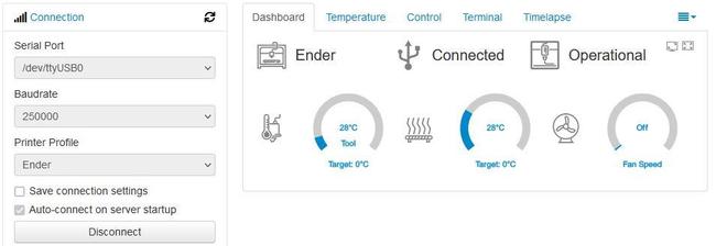

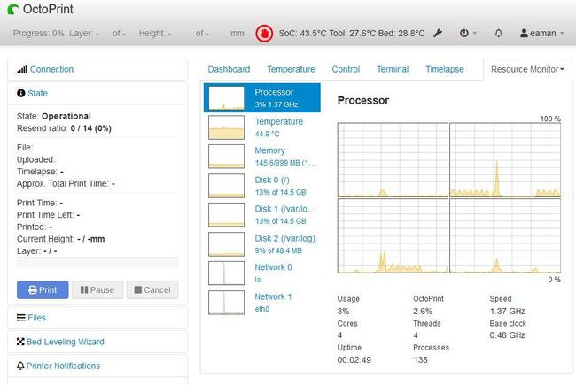

Octoprint e Klipper economico: Orange Pi (PC , Zero)
eaman ha pubblicato una discussione in Software di slicing, firmware e GCode
Se velete fare un setup economico per OctoPrint potete considerare un SOB Orange Pi piuttosto che una RapberryPi 4 che costa un botto. Ho provato a installare un release dedicata per le Orange Pi su una Orange Pi PC che avevo in casa, una SOB 4 core con 1GB di RAM che costa ~25e, e sembra funzionare piu' che bene, nel senso che il consumo di risorse di Octoprint e' ~4% quando stampa la mia Ender 3. Altre Info: Welcome to Armbian 21.05.2 Buster with Linux 5.10.34-sunxi System load: 2% Up time: 10 min Local users: 3 Memory usage: 15% of 999M IP: 192.168.0.4 CPU temp: 49°C Usage of /: 14% of 15G [ General system configuration (beta): armbian-config ] root@orange:~# cat /etc/debian_version 10.9 root@orange:~# lsb_release -a No LSB modules are available. Distributor ID: Debian Description: Debian GNU/Linux 10 (buster) Release: 10 Codename: buster root@orange:~# inxi -S System: Host: orange Kernel: 5.10.34-sunxi armv7l bits: 32 Console: tty 1 Distro: Armbian GNU/Linux 10 (buster) root@orange:~# inxi -F System: Host: orange Kernel: 5.10.34-sunxi armv7l bits: 32 Console: tty 1 Distro: Armbian GNU/Linux 10 (buster) Machine: Type: ARM Device System: Xunlong Orange Pi PC details: Allwinner sun8i Family rev: N/A serial: 02c000814b6e6d89 CPU: Topology: Quad Core model: ARMv7 v7l variant: cortex-a7 bits: 32 type: MCP Speed: 1368 MHz min/max: 480/1368 MHz Core speeds (MHz): 1: 1368 2: 1368 3: 1368 4: 1368 Graphics: Device-1: sun8i-h3-mali driver: lima v: kernel Device-2: sun8i-h3-dw-hdmi driver: sun8i_dw_hdmi v: N/A Device-3: sun8i-h3-display-engine driver: sun4i_drm v: N/A Display: tty server: N/A driver: sun4i_drm tty: 109x61 Message: Unable to show advanced data. Required tool glxinfo missing. Audio: Device-1: sun8i-h3-dw-hdmi driver: sun8i_dw_hdmi Device-2: simple-audio-card driver: asoc_simple_card Sound Server: ALSA v: k5.10.34-sunxi Network: Device-1: sun8i-h3-emac driver: dwmac_sun8i IF: eth0 state: up speed: 100 Mbps duplex: full mac: 02:81:4b:6e:6d:89 Drives: Local Storage: total: 14.94 GiB used: 1.87 GiB (12.5%) ID-1: /dev/mmcblk0 model: SD16G size: 14.94 GiB Partition: ID-1: / size: 14.49 GiB used: 1.87 GiB (12.9%) fs: ext4 dev: /dev/mmcblk0p1 ID-2: /var/log size: 48.4 MiB used: 3.9 MiB (8.0%) fs: ext4 dev: /dev/zram1 Sensors: Missing: Required tool sensors not installed. Check --recommends Info: Processes: 134 Uptime: 16m Memory: 999.0 MiB used: 182.2 MiB (18.2%) Init: systemd runlevel: 5 Shell: bash inxi: 3.0.32 Penso che per far girare solo Klipper potrebbe bastare anche la Orange Pi Zero LTS che ha 512MB RAM, non so se bastano anche per Octoprint. Per il solo Klipper con un frontend leggero magari potrebbe andare bene anche la versione a 256MB per quanto il prezzo cambia di poco... Comunque per chi ha una scheda a 8bit sulla stampante una scheda esterna con Klipper per ~15e potrebbe essere una soluzione interessante 🙂-
