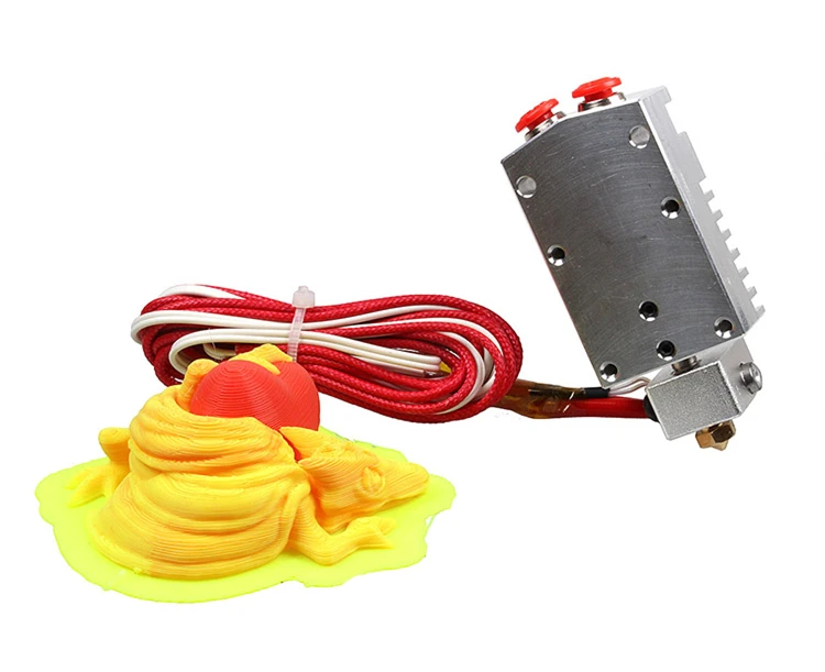

. Ho notato che tu hai montato il secondo estrusore bowden partendo da un direct, che immagino tu abbia usato per spingere il filo. Cercando su Aliexpress però ho trovato doppi estrusori bowden già completi e a prezzi veramente molto bassi. Ti metto il link di alcuni qui sotto:
Estrusore 1
https://it.aliexpress.com/item/1Set-3D-Printer-Chimera-Extruder-Double-Nozzle-Remote-full-Kits-0-4mm-1-75mm-Double-Head/32824783462.html?spm=a2g0y.search0104.3.75.725e74b4wPReK8&ws_ab_test=searchweb0_0,searchweb201602_5_10152_10151_10065_10344_10068_10342_10343_10340_10341_10084_10083_10618_10304_10307_10302_5711211_5722312_10313_10059_10184_10534_100031_10103_10626_10625_10624_10623_10622_10621_10620_10142,searchweb201603_1,ppcSwitch_5&algo_expid=f36aede1-7715-466e-9add-ba8412ea0126-11&algo_pvid=f36aede1-7715-466e-9add-ba8412ea0126&priceBeautifyAB=0
Estrusore 2
https://it.aliexpress.com/item/1-Set-HE3D-V6-dual-Estrusore-Doppio-Ugello-testa-Remote-full-Kit-0-4mm-1-75mm/32839945797.html?spm=a2g0y.search0104.3.213.725e74b4wPReK8&ws_ab_test=searchweb0_0%2Csearchweb201602_5_10152_10151_10065_10344_10068_10342_10343_10340_10341_10084_10083_10618_10304_10307_10302_5711211_5722312_10313_10059_10184_10534_100031_10103_10626_10625_10624_10623_10622_10621_10620_10142%2Csearchweb201603_1%2CppcSwitch_5&algo_expid=f36aede1-7715-466e-9add-ba8412ea0126-31&algo_pvid=f36aede1-7715-466e-9add-ba8412ea0126&priceBeautifyAB=0
Estrusore 3
https://it.aliexpress.com/item/3D-Printer-V6-Hotend-Dual-Head-Extruder-with-0-4mm-Nozzle-12V-Cooling-Fan-and-Effector/32816404336.html?spm=a2g0y.search0104.3.42.725e74b4wPReK8&ws_ab_test=searchweb0_0,searchweb201602_5_10152_10151_10065_10344_10068_10342_10343_10340_10341_10084_10083_10618_10304_10307_10302_5711211_5722312_10313_10059_10184_10534_100031_10103_10626_10625_10624_10623_10622_10621_10620_10142-normal#cfs,searchweb201603_1,ppcSwitch_5&algo_expid=f36aede1-7715-466e-9add-ba8412ea0126-6&algo_pvid=f36aede1-7715-466e-9add-ba8412ea0126&priceBeautifyAB=0
l'ultimo che ho messo non è fatto per la mia stampante, ma si può sempre adattare. Cosa ne pensi? E' meglio comprare tutto insieme o adattare un direct come hai fatto tu?

Nel mio lungo racconto dicevo che il secondo estrusore lo ho comperato per usarlo come ricambio e questo spiega perchè sono partito da due direct e non da un estrusore tipo quelli postati da te.
Sono anche stato molto tentato di comperare qualcosa tipo questo ma in giro ne ho sentito parlare abbastanza male

1)Quindi ricapitolando nella parte terminale usi il dissipatore come raccordo tra il bullone con il teflon e il raccordo pneumatico giusto?
2)Ci hai messo un punto di sigillante o ti sembra che le vibrazioni non smontano il raccordo?
3)La ventola davanti ai dissipatori la metti in estrazione?
4)Vedo dalle foto che a differenza di quelli che si comprano completi* tu usi una ventola sola per entrambi, come hai gestito il flusso d'aria? ovvero tra la ventola e i dissipatori non hai forzato il percorso dell'aria?
5)Per i dissipatori, ho visto che ce ne sono di più grandi, col senno di poi quali preferiresti?
6)Se ci metto un terzo estrusore posso chiamarlo alep? e metterlo sul tuo conto aperto con aliexpress?
E non parlare di class action o mi nascondo a casa tua.
*affare per forzare l'aria
Di luci qui ce ne è cosi tante che sarà il caso di fare un confronto tra i costi delle bollette tra i vari fornitori di energia,.
1) si esatto il dissipatore funge da raccordo (a me piacciono le cose semplici, meno componenti meno problemi)
2) nessun tipo di sigillante e non mi si smonta niente. I dadi hanno funzione di dado e controdado per come sono montati, compreso il dissipatore. la gola arriva a battuta sul raccordo e questo consente di serrare bene tutto.
3) la ventola spinge sui dissipatori ma in teoria è lo stesso
4) cosi funziona benissimo, ed ero convinto da subito che avrebbe funzionato bene e ti spiego perchè, di base l'estrusore "originale" usa un dissipatore in alluminio grandetto ma da li per arrivare alla gola che è l'elemento da raffreddare, fa il giro del mondo e sopratutto la superficie di collegamento tra il dissipatore e la gola non è grande, quindi ritenevo che una ventola diretta avrebbe fatto il suo buon lavoro. Uno dei dissipatori è montato basso perchè stringendo mi si è rotta la gola e quelle che avevo di scorta erano piccole. Poi ho ordinato le gole nuove ma non le ho mai montate perchè funziona benissimo anche cosi
5) i miei funzionano bene, li avrei preferiti più lunghi più che più larghi, diciamo per sicurezza, ma in realtà cosi come sono funzionano benissimo. Se li dovessi avere anche in regalo per natale o dentro l'uovo di pasqua per montarli aspetterei di avere qualche altro problema cosi come per le gole.
6) basta che riesci a farlo passare senza dover pagare dogana.
