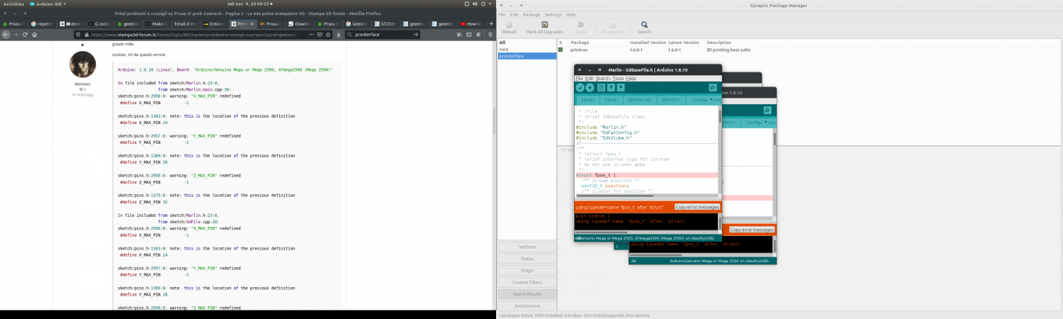

	  Primi problemi e consigli su Prusa I3 prob Geetech [RISOLTO]devilman ha risposto a devilman nella discussione La mia prima stampante 3D grazie mille. curioso, mi da questo errore: Arduino: 1.8.10 (Linux), Board: "Arduino/Genuino Mega or Mega 2560, ATmega2560 (Mega 2560)" In file included from sketch/Marlin.h:23:0, from sketch/Marlin_main.cpp:30: sketch/pins.h:2956:0: warning: "X_MAX_PIN" redefined #define X_MAX_PIN -1 sketch/pins.h:1363:0: note: this is the location of the previous definition #define X_MAX_PIN 24 sketch/pins.h:2957:0: warning: "Y_MAX_PIN" redefined #define Y_MAX_PIN -1 sketch/pins.h:1369:0: note: this is the location of the previous definition #define Y_MAX_PIN 28 sketch/pins.h:2958:0: warning: "Z_MAX_PIN" redefined #define Z_MAX_PIN -1 sketch/pins.h:1375:0: note: this is the location of the previous definition #define Z_MAX_PIN 32 In file included from sketch/Marlin.h:23:0, from sketch/SdFile.cpp:20: sketch/pins.h:2956:0: warning: "X_MAX_PIN" redefined #define X_MAX_PIN -1 sketch/pins.h:1363:0: note: this is the location of the previous definition #define X_MAX_PIN 24 sketch/pins.h:2957:0: warning: "Y_MAX_PIN" redefined #define Y_MAX_PIN -1 sketch/pins.h:1369:0: note: this is the location of the previous definition #define Y_MAX_PIN 28 sketch/pins.h:2958:0: warning: "Z_MAX_PIN" redefined #define Z_MAX_PIN -1 sketch/pins.h:1375:0: note: this is the location of the previous definition #define Z_MAX_PIN 32 In file included from sketch/Marlin.h:23:0, from sketch/SdFatUtil.cpp:20: sketch/pins.h:2956:0: warning: "X_MAX_PIN" redefined #define X_MAX_PIN -1 sketch/pins.h:1363:0: note: this is the location of the previous definition #define X_MAX_PIN 24 sketch/pins.h:2957:0: warning: "Y_MAX_PIN" redefined #define Y_MAX_PIN -1 sketch/pins.h:1369:0: note: this is the location of the previous definition #define Y_MAX_PIN 28 sketch/pins.h:2958:0: warning: "Z_MAX_PIN" redefined #define Z_MAX_PIN -1 sketch/pins.h:1375:0: note: this is the location of the previous definition #define Z_MAX_PIN 32 In file included from sketch/Marlin.h:23:0, from sketch/SdVolume.cpp:20: sketch/pins.h:2956:0: warning: "X_MAX_PIN" redefined #define X_MAX_PIN -1 sketch/pins.h:1363:0: note: this is the location of the previous definition #define X_MAX_PIN 24 sketch/pins.h:2957:0: warning: "Y_MAX_PIN" redefined #define Y_MAX_PIN -1 sketch/pins.h:1369:0: note: this is the location of the previous definition #define Y_MAX_PIN 28 sketch/pins.h:2958:0: warning: "Z_MAX_PIN" redefined #define Z_MAX_PIN -1 sketch/pins.h:1375:0: note: this is the location of the previous definition #define Z_MAX_PIN 32 sketch/Marlin_main.cpp:2667:36: warning: invalid suffix on literal; C++11 requires a space between literal and string macro [-Wliteral-suffix] LCD_MESSAGEPGM(MACHINE_NAME" "MSG_OFF"."); ^ In file included from sketch/Marlin.h:23:0, from sketch/SdBaseFile.cpp:21: sketch/pins.h:2956:0: warning: "X_MAX_PIN" redefined #define X_MAX_PIN -1 sketch/pins.h:1363:0: note: this is the location of the previous definition #define X_MAX_PIN 24 sketch/pins.h:2957:0: warning: "Y_MAX_PIN" redefined #define Y_MAX_PIN -1 sketch/pins.h:1369:0: note: this is the location of the previous definition #define Y_MAX_PIN 28 sketch/pins.h:2958:0: warning: "Z_MAX_PIN" redefined #define Z_MAX_PIN -1 sketch/pins.h:1375:0: note: this is the location of the previous definition #define Z_MAX_PIN 32 In file included from sketch/Marlin.h:23:0, from sketch/thermistortables.h:4, from sketch/Configuration.h:792, from /home/dalkiel3/Downloads/Marlin-PI3_Pro_B/Marlin/Marlin.ino:33: sketch/pins.h:2956:0: warning: "X_MAX_PIN" redefined #define X_MAX_PIN -1 sketch/pins.h:1363:0: note: this is the location of the previous definition #define X_MAX_PIN 24 sketch/pins.h:2957:0: warning: "Y_MAX_PIN" redefined #define Y_MAX_PIN -1 sketch/pins.h:1369:0: note: this is the location of the previous definition #define Y_MAX_PIN 28 sketch/pins.h:2958:0: warning: "Z_MAX_PIN" redefined #define Z_MAX_PIN -1 sketch/pins.h:1375:0: note: this is the location of the previous definition #define Z_MAX_PIN 32 In file included from sketch/SdFile.h:27:0, from sketch/SdFile.cpp:23: SdBaseFile.h:38:8: error: using typedef-name 'fpos_t' after 'struct' struct fpos_t { ^~~~~~ In file included from sketch/Marlin.h:10:0, from sketch/SdFile.cpp:20: /home/dalkiel3/Downloads/arduino-1.8.10/hardware/tools/avr/avr/include/stdio.h:950:33: note: 'fpos_t' has a previous declaration here __extension__ typedef long long fpos_t; ^~~~~~ In file included from sketch/SdFile.h:27:0, from sketch/cardreader.h:8, from sketch/Marlin_main.cpp:44: SdBaseFile.h:38:8: error: using typedef-name 'fpos_t' after 'struct' struct fpos_t { ^~~~~~ In file included from sketch/Marlin.h:10:0, from sketch/Marlin_main.cpp:30: /home/dalkiel3/Downloads/arduino-1.8.10/hardware/tools/avr/avr/include/stdio.h:950:33: note: 'fpos_t' has a previous declaration here __extension__ typedef long long fpos_t; ^~~~~~ In file included from sketch/Marlin.h:23:0, from sketch/thermistortables.h:4, from sketch/Configuration.h:792, from sketch/Servo.cpp:44: sketch/pins.h:2956:0: warning: "X_MAX_PIN" redefined #define X_MAX_PIN -1 sketch/pins.h:1363:0: note: this is the location of the previous definition #define X_MAX_PIN 24 sketch/pins.h:2957:0: warning: "Y_MAX_PIN" redefined #define Y_MAX_PIN -1 sketch/pins.h:1369:0: note: this is the location of the previous definition #define Y_MAX_PIN 28 sketch/pins.h:2958:0: warning: "Z_MAX_PIN" redefined #define Z_MAX_PIN -1 sketch/pins.h:1375:0: note: this is the location of the previous definition #define Z_MAX_PIN 32 In file included from sketch/SdBaseFile.cpp:24:0: SdBaseFile.h:38:8: error: using typedef-name 'fpos_t' after 'struct' struct fpos_t { ^~~~~~ In file included from sketch/Marlin.h:10:0, from sketch/SdBaseFile.cpp:21: /home/dalkiel3/Downloads/arduino-1.8.10/hardware/tools/avr/avr/include/stdio.h:950:33: note: 'fpos_t' has a previous declaration here __extension__ typedef long long fpos_t; ^~~~~~ sketch/SdBaseFile.cpp: In member function 'void SdBaseFile::getpos(fpos_t*)': SdBaseFile.cpp:298:8: error: request for member 'position' in '* pos', which is of non-class type 'fpos_t {aka long long int}' pos->position = curPosition_; ^~~~~~~~ SdBaseFile.cpp:299:8: error: request for member 'cluster' in '* pos', which is of non-class type 'fpos_t {aka long long int}' pos->cluster = curCluster_; ^~~~~~~ sketch/SdBaseFile.cpp: In member function 'void SdBaseFile::setpos(fpos_t*)': SdBaseFile.cpp:1496:23: error: request for member 'position' in '* pos', which is of non-class type 'fpos_t {aka long long int}' curPosition_ = pos->position; ^~~~~~~~ SdBaseFile.cpp:1497:22: error: request for member 'cluster' in '* pos', which is of non-class type 'fpos_t {aka long long int}' curCluster_ = pos->cluster; ^~~~~~~ In file included from sketch/Marlin.h:23:0, from sketch/cardreader.cpp:1: sketch/pins.h:2956:0: warning: "X_MAX_PIN" redefined #define X_MAX_PIN -1 sketch/pins.h:1363:0: note: this is the location of the previous definition #define X_MAX_PIN 24 sketch/pins.h:2957:0: warning: "Y_MAX_PIN" redefined #define Y_MAX_PIN -1 sketch/pins.h:1369:0: note: this is the location of the previous definition #define Y_MAX_PIN 28 sketch/pins.h:2958:0: warning: "Z_MAX_PIN" redefined #define Z_MAX_PIN -1 sketch/pins.h:1375:0: note: this is the location of the previous definition #define Z_MAX_PIN 32 In file included from sketch/SdFile.h:27:0, from sketch/cardreader.h:8, from sketch/cardreader.cpp:2: SdBaseFile.h:38:8: error: using typedef-name 'fpos_t' after 'struct' struct fpos_t { ^~~~~~ In file included from sketch/Marlin.h:10:0, from sketch/cardreader.cpp:1: /home/dalkiel3/Downloads/arduino-1.8.10/hardware/tools/avr/avr/include/stdio.h:950:33: note: 'fpos_t' has a previous declaration here __extension__ typedef long long fpos_t; ^~~~~~ Multiple libraries were found for "LiquidCrystal.h" Used: /home/dalkiel3/Downloads/arduino-1.8.10/libraries/LiquidCrystal exit status 1 using typedef-name 'fpos_t' after 'struct' This report would have more information with "Show verbose output during compilation" option enabled in File -> Preferences. e non mi fa uploadare screenshot
	  Primi problemi e consigli su Prusa I3 prob Geetech [RISOLTO]devilman ha risposto a devilman nella discussione La mia prima stampante 3D ubuntu, ide 1.8.10, installata, sembra andare tutto, ma non carica il suddetto file.hex... hai un link da usare che faccio prima, dato che il forum geetech è down al momento?
