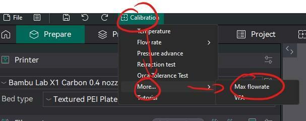

https://github.com/SoftFever/OrcaSlicer/wiki/Calibration#Max-Volumetric-speed https://www.obico.io/blog/maximum-volumetric-speed-test-in-orcaslicer-a-comprehensive-guide/
