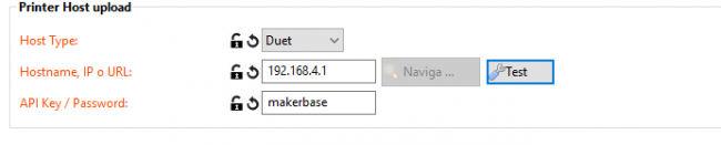

	MKS-Robin V.2.4 STM32 Scheda Madre e Controller Board con TFT 3 .2 POLLICI TOUCHroberto76milano ha risposto a roberto76milano nella discussione Hardware e componenti mi esce duet o octoprint ma io non ho ne uno ne' l'altro questo e' il file di configurazione firware #------------------------------------------------------------- ############ Based Settings( Required) ####################### #machine type #0:xyz #1:corexy(x_motor = x+y, y_motor = x-y), #2:corexy(x_motor = x+y, y_motor = y-x), #3:delta >DRIVE_SYSTEM 0 #machine type >cfg_multiple_language 1 #multi-language(enable:1, disable:0) >cfg_language_type 7 #languages setting,this configuration is valid when "cfg_multiple_language" is disabled. #(simplified Chinese:1; traditional Chinese:2; English:3; Russian:4; Spanish:5;French:6;Italian:7). >NUM_EXTRUDER 1 #number of extruder (1:singal£»2:dual) >HAVE_HEATED_BED 1 #1:enable bed; 0:disable bed >EXT0_TEMPSENSOR_TYPE 1 #1:100k thermistor£»102: MAX31855 thermocouple >EXT1_TEMPSENSOR_TYPE 0 #1:100k thermistor£»102: MAX31855 thermocouple >HEATED_BED_SENSOR_TYPE 1 #1:100k thermistor£» >FEATURE_TWO_XSTEPPER 0 #change E1 singal into X , then dual X is available(enable:1; disable: 0) >FEATURE_TWO_YSTEPPER 0 #change E1 singal into Y , then dual Y is available(enable:1; disable: 0) >FEATURE_TWO_ZSTEPPER 1 #change E1 singal into Z , then dual Z is available(enable:1; disable: 0) #--------------------------------------------------------------- ################# Machine settings ############################ >EXT1_X_OFFSET -4 #E1 offset from the origin of X axis (mm) >EXT1_Y_OFFSET 200 #E1 offset from the origin of Y axis (mm) >INVERT_X_DIR 0 #X motor direction, 1 goes opposite direction; >INVERT_Y_DIR 1 #Y motor direction, 1 goes opposite direction; >INVERT_Z_DIR 0 #Z motor direction, 1 goes opposite direction; >EXT0_INVERSE 0 #E0motor direction, 1 goes opposite direction; >EXT1_INVERSE 1 #E1motor direction, 1 goes opposite direction; >XAXIS_STEPS_PER_MM 80.6 #X steps per mm >YAXIS_STEPS_PER_MM 161.4 #Y steps per mm >ZAXIS_STEPS_PER_MM 800 #Z steps per mm >EXT0_STEPS_PER_MM 191.17 #E0 steps per mm >EXT1_STEPS_PER_MM 800 #E1 steps per mm >X_MAX_LENGTH 200 #the MAX X-axis distance >Y_MAX_LENGTH 200 #the MAX Y-axis distance >Z_MAX_LENGTH 190 #the MAX Z-axis distance >X_MIN_POS 0 #the MIN X-axis distance >Y_MIN_POS 0 #the MIN Y-axis distance >Z_MIN_POS 0 #the MIN Z-axis distance >MIN_EXTRUDER_TEMP 175 #MIN TEMP on Extruder ,play a protective role >MAX_EXTRUDER_TEMP 275 #MAX TEMP on Extruder ,play a protective role >MAX_HEATED_BED_TEMP 150 #MAX TEMP on heated bed £¬play a protective role >HOMING_ORDER 1 #Set direction of endstops when homing; >X_HOME_DIR -1 #Homing direction(-1:MIN£¬1:MAX) >Y_HOME_DIR -1 #Homing direction(-1:MIN£¬1:MAX) >Z_HOME_DIR -1 #Homing direction(-1:MIN£¬1:MAX) >HOMING_FEEDRATE_X 40 #the feedrate on X homing >HOMING_FEEDRATE_Y 40 #the feedrate on Y homing >HOMING_FEEDRATE_Z 10 #the feedrate on Z homing # 1 means endstop always-on,0 is always-off >ENDSTOP_X_MIN_INVERTING 0 >ENDSTOP_Y_MIN_INVERTING 0 >ENDSTOP_Z_MIN_INVERTING 0 >ENDSTOP_X_MAX_INVERTING 0 >ENDSTOP_Y_MAX_INVERTING 0 >ENDSTOP_Z_MAX_INVERTING 0 # 1 for Min/Max endstop enable in hardware,while 0 disable >MIN_HARDWARE_ENDSTOP_X 1 >MIN_HARDWARE_ENDSTOP_Y 1 >MIN_HARDWARE_ENDSTOP_Z 1 >MAX_HARDWARE_ENDSTOP_X 0 >MAX_HARDWARE_ENDSTOP_Y 0 >MAX_HARDWARE_ENDSTOP_Z 0 # 1 for Min/Max endstop enable in software,while 0 disable >min_software_endstop_x 0 >min_software_endstop_y 0 >min_software_endstop_z 0 >max_software_endstop_x 0 >max_software_endstop_y 0 >max_software_endstop_z 0 >MAX_FEEDRATE_X 200 #the Max feedrate of X moving mm/s >MAX_FEEDRATE_Y 200 #the Max feedrate of Y moving mm/s >MAX_FEEDRATE_Z 40 #the Max feedrate of Z moving mm/s >MAX_FEEDRATE_EXT0 200 #the Max feedrate of E0 moving mm/s >MAX_FEEDRATE_EXT1 200 #the Max feedrate of E1 moving mm/s >MAX_ACCELERATION_UNITS_PER_SQ_SECOND_X 1000 #the Max acculeration of X printing mm/s^2 >MAX_ACCELERATION_UNITS_PER_SQ_SECOND_Y 1000 #the Max acculeration of Y printing mm/s^2 >MAX_ACCELERATION_UNITS_PER_SQ_SECOND_Z 500 #the Max acculeration of Z printing mm/s^2 >MAX_ACCELERATION_EXT0 1000 #the Max acculeration of E0 printing mm/s^2 >MAX_ACCELERATION_EXT1 1000 #the Max acculeration of E1 printing mm/s^2 >MAX_TRAVEL_ACCELERATION_UNITS_PER_SQ_SECOND_X 1000 #MAX acceleration of X-axis moving mm/s^2 >MAX_TRAVEL_ACCELERATION_UNITS_PER_SQ_SECOND_Y 1000 #MAX acceleration of Y-axis moving mm/s^2 >MAX_TRAVEL_ACCELERATION_UNITS_PER_SQ_SECOND_Z 200 #MAX acceleration of Z-axis moving mm/s^2 #--------------------------------------------------------------- ################ Delta Settings ############################## >DELTA_MAX_RADIUS 135 #the radius of Delta annulus >PRINTER_RADIUS 197 #the distance from machine center to vertical top >DELTA_DIAGONAL_ROD 346.75 #the length of Delta pole >DELTA_FLOOR_SAFETY_MARGIN_MM 15 #the safe distance of leveling edge >END_EFFECTOR_HORIZONTAL_OFFSET 28.0 # >CARRIAGE_HORIZONTAL_OFFSET 14.5 # >ROD_RADIUS 169 # #------------------------------------------------------------- ################## Advanced Settings############################# >cfg_insert_det_module 0 #Assemble power outage module (1:mks 220det;0:mks pwc) >cfg_have_ups_device 0 # UPS(1:yes;0:no) >cfg_print_over_auto_close 0 # auto-off when print finishes(1:yes£»0:no) >cfg_filament_det_trigger_level 0 #the level signal of outage detection module (1:high level;0:low level) >cfg_filament_load_length 100 #the lenght to extrude filament (mm),Max:2000mm >cfg_filament_load_speed 400 #the speed to extrude filament(mm/min) >cfg_filament_load_limit_temperature 200 #It is the minimum temperature to extrude filament . >cfg_filament_unload_length 100 #the length to retract filament(mm),Max:2000mm >cfg_filament_unload_speed 400 #the speed to retract filament(mm/min) >cfg_filament_unload_limit_temperature 200 #It is the minimum temperature to retract filament . #------------------------------------------------------------- ################# Bed Leveling ############################# #Leveling mode settings >cfg_leveling_mode 0 #1:auto-leveling; 0:manual leveling ########## Manual Leveling ############# #manual leveling >cfg_point_number 5 #the point number of manual leveling(3,4,5 point available) #the 5 point location of manual leveling >cfg_point1:40,170 >cfg_point2:175,170 >cfg_point3:175,30 >cfg_point4:40,30 >cfg_point5:110,100 ########### Auto Leveling ############## >cfg_auto_leveling_cmd:G28;G32 S2; #the setting of auto-leveling command button >FEATURE_Z_PROBE 0 #0:disable leveling£¬1:enable leveling >BED_LEVELING_METHOD 1 #0:3 points leveling,1:more points leveling,2: 4 points leveling >Z_PROBE_ON_HIGH 1 #Probe signal(0: low level,always on; 1:high level,always off) >Z_PROBE_HEIGHT -0.8 #the height difference between Z-probe and nozzle >Z_PROBE_X1 -90 #coordinateX1 is preset point >Z_PROBE_Y1 -90 #coordinateY1 is preset point >Z_PROBE_X2 90 #coordinateX2 is preset point >Z_PROBE_Y2 -90 #coordinateY2 is preset point >Z_PROBE_X3 -90 #coordinateX3 is preset point >Z_PROBE_Y3 90 #coordinateY3 is preset point >cfg_leveling_z_speed 1500 #the speed of Z moving when manual leveling(mm/min) >cfg_leveling_xy_speed 3000 #the speed of XY moving when manual leveling (mm/min) >BED_LEVELING_GRID_SIZE 5 #leveling interval >Z_PROBE_SPEED 30 #the speed of Z-probe >Z_PROBE_XY_SPEED 100 #the speed of XY #--------------------------------------------------------------- ################# Wireless ##################################### >cfg_wifi_mode:1 #wifi mode(0:sta;1:ap) >cfg_wifi_ap_name:MKS-WIFI #wifi name >cfg_wifi_key_code:makerbase #wifi password >cfg_cloud_enable:0 #0:disable cloud service 1:enable cloud service >cfg_wifi_cloud_host:www.baizhongyun.cn #cloud service adress >cfg_cloud_port:10086 #cloud service port #---------------------------------------------------------------- ############### Special Setup(default) ###################### >STEPPER_HIGH_DELAY 0 #Pulse hold time setting(unit: us) #For inverting stepper enable pins >X_ENABLE_ON 0 >Y_ENABLE_ON 0 >Z_ENABLE_ON 0 >EXT0_ENABLE_ON 0 >EXT1_ENABLE_ON 0 #Type of heat manager for this extruder. #- 0 = Simply switch on/off if temperature is reached. #- 1 = PID Temperature control. #- 3 = Dead-time control. >EXT0_HEAT_MANAGER 1 # >EXT1_HEAT_MANAGER 1 # #the PID setting of extruder >EXT0_PID_INTEGRAL_DRIVE_MAX 230 #the Max value of PID integral saturation >EXT0_PID_INTEGRAL_DRIVE_MIN 40 #the Min value of PID integral saturation >EXT0_PID_P 24 #the setting of P value >EXT0_PID_I 0.88 #the setting of I value >EXT0_PID_D 80 #the setting of D value >EXT1_PID_INTEGRAL_DRIVE_MAX 230 #the Max value of PID integral saturation >EXT1_PID_INTEGRAL_DRIVE_MIN 40 #the Min value of PID integral saturation >EXT1_PID_P 24 #the setting of P value >EXT1_PID_I 0.88 #the setting of I value >EXT1_PID_D 80 #the setting of D value #------------------------------------------------------------- ####### Display Effect(refer to MKS TFT datasheet) ########### #user-defined function1 and 2 >setmenu_func1_display 1 #1:display this button£¬0:no >setmenu_func2_display 0 #1:display this button; 0:not display #each command must be separated by semicolon ";" >setmenu_func1:M84; >setmenu_func2:M81; >moreitem_pic_cnt 0 #the number of "more" button #edit command for 1~7 "More" button #each command must be separated by semicolon ";" #each icon command must be less than 200 bytes >moreitem_button1_cmd:G28 X0;G28 Y0;G28 Z0; >moreitem_button2_cmd:G28 X0;G28 Y0;G28 Z0; >moreitem_button3_cmd:G28 X0;G28 Y0;G28 Z0; >moreitem_button4_cmd:G28 X0;G28 Y0;G28 Z0; >moreitem_button5_cmd:G28 X0;G28 Y0;G28 Z0; >moreitem_button6_cmd:G28 X0;G28 Y0;G28 Z0; >moreitem_button7_cmd:G28 X0;G28 Y0;G28 Z0; #the number of "more" button to dispaly on printing interface >morefunc_cnt:0 #button1~button6 function >morefunc1_cmd:G28; >morefunc2_cmd:G28; >morefunc3_cmd:G28; >morefunc4_cmd:G28; >morefunc5_cmd:G28; >morefunc6_cmd:G28; #---------------------------------------------------------------- ############## Display Customization ####################### >cfg_background_color 0x000000 #the color of screen background >cfg_title_color 0xFFFFFF #the color of title text >cfg_state_background_color 0x000000 #the color of temperature,fan,(etc)background >cfg_state_text_color 0xFFFFFF #the color of temprature,fan,(etc) text >cfg_filename_background_color 0x000000 #the color of file button >cfg_filename_color 0xFFFFFF #the color of file text >cfg_printingstat_word_background_color 0x000000 #the color of background in printing status >cfg_printingstat_word_color 0xFFFFFF #the color of text in printing status >cfg_BUTTON_3D_effects 0 #3D effects setting (disable: 0, enable: 1)

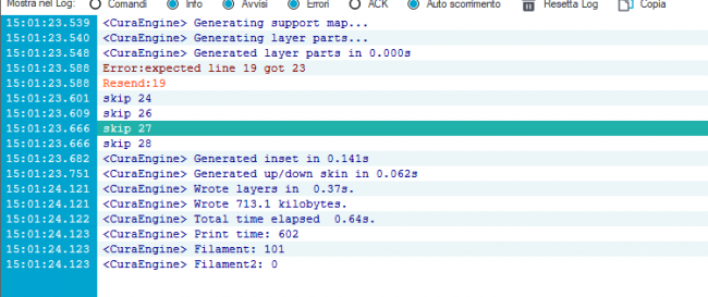

	MKS-Robin V.2.4 STM32 Scheda Madre e Controller Board con TFT 3 .2 POLLICI TOUCHroberto76milano ha risposto a roberto76milano nella discussione Hardware e componenti no il pc non va mai in stanby il file log te lo ho postato quado si blocca esce la scritta in rosso, non fa scrivere gcode perche' e' software proprietario. mi servirebbe forse un altro software host che faccia la wifi. slic3r lo ho ma non l'ho mai usato non so come impostarlo in wifi
	MKS-Robin V.2.4 STM32 Scheda Madre e Controller Board con TFT 3 .2 POLLICI TOUCHroberto76milano ha risposto a roberto76milano nella discussione Hardware e componenti si blocca lo stesso!!!

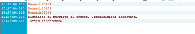

	MKS-Robin V.2.4 STM32 Scheda Madre e Controller Board con TFT 3 .2 POLLICI TOUCHroberto76milano ha risposto a roberto76milano nella discussione Hardware e componenti ho provato a impostare come porta 80 ma non si connette con 8080 si . io faccio lo slicer con repetierhost poi lancio la stampa subito da li' di solito senza sd card senza cavo usb. allego log dopo avvio di connessione
	MKS-Robin V.2.4 STM32 Scheda Madre e Controller Board con TFT 3 .2 POLLICI TOUCHroberto76milano ha risposto a roberto76milano nella discussione Hardware e componenti allora rispondo ad entrambi, io mi connetto alla wifi della scheda sulla scheda madre, da pc a scheda, funziona, l'unico problema e' che dopo un po' a volte si ferma la stampa per poi ripartire 1 minuto o 2 dopo inutile dire che questo rovina la stampa in quanto l'ugello scioglie la parte, molto fastidiosa questa cosa ho provato a impostare diversamente la comunicazione ma non cambia....ho cercato in internet ma anche li ho trovato poco e ancora non ho risolto, quindi sono tornato a caricare manualmente su sd ogni volta e se stampo roba piccola e semplice lo faccio da wifi (ma comunque a volte si blocca e devo rifare. se la consiglio questa scheda???SI DI BRUTTO funziona alla grande e' comodissima e la qualita' di stampa e' migliorata davvero tanto pezzi piu' puliti, piu' lisci e stampati piu' velocemente!!! la differenza si vede eccome, oltretutto regli tutto comodamente sopprattutto il livellamento manuale e' stra comodo. all'inizio avevo dubbi sul firmware originale ma ora so' che va da dio e non serve cambiarlo con altri puoi regolare tutto anche le icone sul display e tante altre cose (che manco ho fatto perche' secondo le mie esigenze va benissimo come e'. la vecchia 8 bit ora la considero solo immondizia per neofiti si dovrebbe regolare tutto da qua' ma ci capisco poco magari sbaglio porta la chace l'ho regolata diverse volte portandola al minimo ma ancora non funziona bene, il timeout non so' come impostarlo
	MKS-Robin V.2.4 STM32 Scheda Madre e Controller Board con TFT 3 .2 POLLICI TOUCHroberto76milano ha risposto a roberto76milano nella discussione Hardware e componenti ok ce l'ho fatta!!!!!!!!!!!!!!!!!!!!!!!!!!!!!!!! 😄 ora funziona repetier si connette e riesco a muovere la stampante da pc via wifi senza usare nessun modem o server...figata ora devo fare partire una stampa e vedere cosa succede se chiudo repetier (penso che si ferma la stampa...spero tanto di no altrimenti e' un po' inutile la wifi). nel caso si ferma la stampa allora converrebbe collegarsi al cloud con accesso a internet e caricare il file sul cloud cosi' la scheda se lo prende da li' in automatico ma non avendo wifi in casa e' un casino dovrei connettermi al hotspot del cellulare ma comunque serve sempre il cellulare acceso e connesso.
	MKS-Robin V.2.4 STM32 Scheda Madre e Controller Board con TFT 3 .2 POLLICI TOUCHroberto76milano ha risposto a roberto76milano nella discussione Hardware e componenti mi sono connesso mettendo la password e si connette ma poi come imposto repetier o meglio come si usa una volta connessi?
