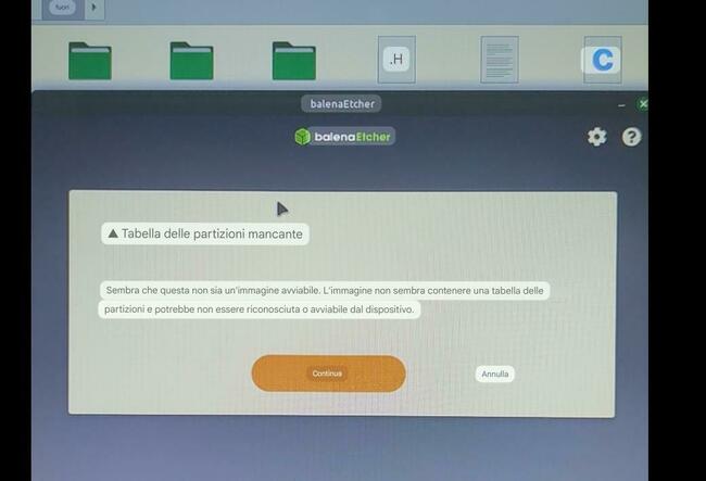

scaricato È normale che quando vado a prendere il bin per flesciare con balena da questo messaggio ? -

riprovo , se non sbaglio avevo scaricato il tuo ma riprovo Google Drive ha rilevato problemi relativi al tuo download Questo file è troppo grande per la scansione antivirus di Google. Questo file è un eseguibile e può danneggiare il computer. sovolized-03-numpy.img (7,3G) e' questo ? -

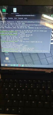

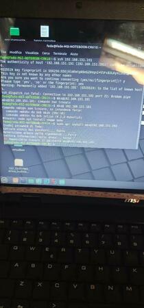

ede@fede-MSI-NOTEBOOK-CR610:~$ ssh mks@192.168.151.191 mks@192.168.151.191's password: Connection closed by 192.168.151.191 port 22 fede@fede-MSI-NOTEBOOK-CR610:~$ sudo ssh mks@192.168.151.191 [sudo] password di fede: The authenticity of host '192.168.151.191 (192.168.151.191)' can't be established. ED25519 key fingerprint is SHA256:D5bjAlmEmtpN9eGZ0VqnI+VtFsB3L6yXc3Sbtpx2HI0. This key is not known by any other names Are you sure you want to continue connecting (yes/no/[fingerprint])? yes Warning: Permanently added '192.168.151.191' (ED25519) to the list of known hosts. mks@192.168.151.191's password: Permission denied, please try again. mks@192.168.151.191's password: Permission denied, please try again. mks@192.168.151.191's password: mks@192.168.151.191: Permission denied (publickey,password). fede@fede-MSI-NOTEBOOK-CR610:~$ sudo apt ssh mks@192.168.151.191 This is the Linux Mint "apt" command. This commands acts as a wrapper for the APT package manager and many other useful tools such as apt-get, apt-cache, apt-mark, dpkg, aptitude...etc. It is installed in /usr/local/bin/apt. To use the upstream apt command directly type /usr/bin/apt. Usage: apt command [options] apt help command [options] Commands: add-repository - Add entries to apt sources.list autoclean - Erase cache for packages no longer available autopurge - Erase system-wide config files left by removed packages autoremove - Remove dependency packages no longer required build - Build binary or source packages from sources build-dep - Configure build-dependencies for source packages changelog - View a package's changelog check - Verify there are no broken dependencies clean - Erase downloaded archive files contains - List packages containing a file content - List files contained in and installed by a package(s) deb - Install a local .deb package depends - Show package dependency information dist-upgrade - Fully upgrade the system by allowing other package changes download - Download packages to the current working directory edit-sources - Edit /etc/apt/sources.list with your preferred text editor dselect-upgrade - Follow dselect selections full-upgrade - Same as 'dist-upgrade' held - List all held packages help - Show help for a command hold - Hold a package install - Install and/or upgrade packages list - List packages handled by the system (e.g., installed) policy - Show policy settings purge - Remove packages and their system-wide configuration files recommends - List missing recommended packages for a particular package rdepends - Show reverse dependency information for a package reinstall - Reinstall packages or install if not yet installed remove - Remove packages search - Search for a package by name and/or expression show - Display detailed information about a package showhold - Same as 'held' showsrc - Display source package records matching the given package source - Download source archives sources - Same as 'edit-sources' unhold - Unhold a package update - Download lists of new/upgradable packages upgrade - Perform a safe upgrade version - Show the installed version of a package fede@fede-MSI-NOTEBOOK-CR610:~$ sudo ssh mks@192.168.151.191 mks@192.168.151.191's password: Permission denied, please try again. mks@192.168.151.191's password: ede@fede-MSI-NOTEBOOK-CR610:~$ ssh mks@192.168.151.191 mks@192.168.151.191's password: Connection closed by 192.168.151.191 port 22 fede@fede-MSI-NOTEBOOK-CR610:~$ sudo ssh mks@192.168.151.191 [sudo] password di fede: The authenticity of host '192.168.151.191 (192.168.151.191)' can't be established. ED25519 key fingerprint is SHA256:D5bjAlmEmtpN9eGZ0VqnI+VtFsB3L6yXc3Sbtpx2HI0. This key is not known by any other names Are you sure you want to continue connecting (yes/no/[fingerprint])? yes Warning: Permanently added '192.168.151.191' (ED25519) to the list of known hosts. mks@192.168.151.191's password: Permission denied, please try again. mks@192.168.151.191's password: Permission denied, please try again. mks@192.168.151.191's password: mks@192.168.151.191: Permission denied (publickey,password). fede@fede-MSI-NOTEBOOK-CR610:~$ sudo apt ssh mks@192.168.151.191 This is the Linux Mint "apt" command. This commands acts as a wrapper for the APT package manager and many other useful tools such as apt-get, apt-cache, apt-mark, dpkg, aptitude...etc. It is installed in /usr/local/bin/apt. To use the upstream apt command directly type /usr/bin/apt. Usage: apt command [options] apt help command [options] Commands: add-repository - Add entries to apt sources.list autoclean - Erase cache for packages no longer available autopurge - Erase system-wide config files left by removed packages autoremove - Remove dependency packages no longer required build - Build binary or source packages from sources build-dep - Configure build-dependencies for source packages changelog - View a package's changelog check - Verify there are no broken dependencies clean - Erase downloaded archive files contains - List packages containing a file content - List files contained in and installed by a package(s) deb - Install a local .deb package depends - Show package dependency information dist-upgrade - Fully upgrade the system by allowing other package changes download - Download packages to the current working directory edit-sources - Edit /etc/apt/sources.list with your preferred text editor dselect-upgrade - Follow dselect selections full-upgrade - Same as 'dist-upgrade' held - List all held packages help - Show help for a command hold - Hold a package install - Install and/or upgrade packages list - List packages handled by the system (e.g., installed) policy - Show policy settings purge - Remove packages and their system-wide configuration files recommends - List missing recommended packages for a particular package rdepends - Show reverse dependency information for a package reinstall - Reinstall packages or install if not yet installed remove - Remove packages search - Search for a package by name and/or expression show - Display detailed information about a package showhold - Same as 'held' showsrc - Display source package records matching the given package source - Download source archives sources - Same as 'edit-sources' unhold - Unhold a package update - Download lists of new/upgradable packages upgrade - Perform a safe upgrade version - Show the installed version of a package fede@fede-MSI-NOTEBOOK-CR610:~$ sudo ssh mks@192.168.151.191 mks@192.168.151.191's password: Permission denied, please try again. mks@192.168.151.191's password: -MSI-NOTEBOOK-CR610:~$ ssh mks@192.168.151.191 mks@192.168.151.191's password: Permission denied, please try again. mks@192.168.151.191's password: Connection closed by 192.168.151.191 port 22 fede@fede-MSI-NOTEBOOK-CR610:~$ ssh mks@192.168.151.191 mks@192.168.151.191's password: Permission denied, please try again. mks@192.168.151.191's password: Connection closed by 192.168.151.191 port 22 fede@fede-MSI-NOTEBOOK-CR610:~$ ssh mks@192.168.151.191 mks@192.168.151.191's password: Connection closed by 192.168.151.191 port 22 fede@fede-MSI-NOTEBOOK-CR610:~$ sudo ssh mks@192.168.151.191 [sudo] password di fede: The authenticity of host '192.168.151.191 (192.168.151.191)' can't be established. ED25519 key fingerprint is SHA256:D5bjAlmEmtpN9eGZ0VqnI+VtFsB3L6yXc3Sbtpx2HI0. This key is not known by any other names Are you sure you want to continue connecting (yes/no/[fingerprint])? yes Warning: Permanently added '192.168.151.191' (ED25519) to the list of known hosts. mks@192.168.151.191's password: Permission denied, please try again. mks@192.168.151.191's password: Permission denied, please try again. mks@192.168.151.191's password: mks@192.168.151.191: Permission denied (publickey,password). fede@fede-MSI-NOTEBOOK-CR610:~$ sudo apt ssh mks@192.168.151.191 This is the Linux Mint "apt" command. This commands acts as a wrapper for the APT package manager and many other useful tools such as apt-get, apt-cache, apt-mark, dpkg, aptitude...etc. It is installed in /usr/local/bin/apt. To use the upstream apt command directly type /usr/bin/apt. Usage: apt command [options] apt help command [options] Commands: add-repository - Add entries to apt sources.list autoclean - Erase cache for packages no longer available autopurge - Erase system-wide config files left by removed packages autoremove - Remove dependency packages no longer required build - Build binary or source packages from sources build-dep - Configure build-dependencies for source packages changelog - View a package's changelog check - Verify there are no broken dependencies clean - Erase downloaded archive files contains - List packages containing a file content - List files contained in and installed by a package(s) deb - Install a local .deb package depends - Show package dependency information dist-upgrade - Fully upgrade the system by allowing other package changes download - Download packages to the current working directory edit-sources - Edit /etc/apt/sources.list with your preferred text editor dselect-upgrade - Follow dselect selections full-upgrade - Same as 'dist-upgrade' held - List all held packages help - Show help for a command hold - Hold a package install - Install and/or upgrade packages list - List packages handled by the system (e.g., installed) policy - Show policy settings purge - Remove packages and their system-wide configuration files recommends - List missing recommended packages for a particular package rdepends - Show reverse dependency information for a package reinstall - Reinstall packages or install if not yet installed remove - Remove packages search - Search for a package by name and/or expression show - Display detailed information about a package showhold - Same as 'held' showsrc - Display source package records matching the given package source - Download source archives sources - Same as 'edit-sources' unhold - Unhold a package update - Download lists of new/upgradable packages upgrade - Perform a safe upgrade version - Show the installed version of a package fede@fede-MSI-NOTEBOOK-CR610:~$ sudo ssh mks@192.168.151.191 mks@192.168.151.191's password: Permission denied, please try again. mks@192.168.151.191's password: Connection closed by 192.168.151.191 port 22 fede@fede-MSI-NOTEBOOK-CR610:~$ sudo ssh mks@192.168.151.191 mks@192.168.151.191's password: Permission denied, please try again. mks@192.168.151.191's password: Permission denied, please try again. mks@192.168.151.191's password: mks@192.168.151.191: Permission denied (publickey,password). fede@fede-MSI-NOTEBOOK-CR610:~$ messe tutte le passwoerd possibili, inizialmente mi aveva dato : sudo] password di fede: The authenticity of host '192.168.151.191 (192.168.151.191)' can't be established. ED25519 key fingerprint is SHA256:D5bjAlmEmtpN9eGZ0VqnI+VtFsB3L6yXc3Sbtpx2HI0. This key is not known by any other names Are you sure you want to continue connecting (yes/no/[fingerprint])? yes Warning: Permanently added '192.168.151.191' (ED25519) to the list of known hosts. -

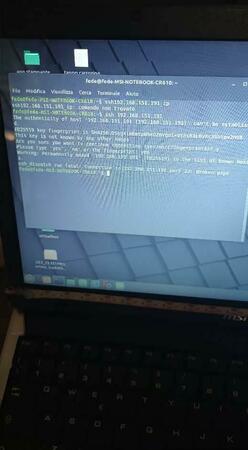

ede@fede-MSI-NOTEBOOK-CR610:~$ ls dev ls: impossibile accedere a 'dev': File o directory non esistente fede@fede-MSI-NOTEBOOK-CR610:~$ ssh mks@192.168.151.191 mks@192.168.151.191's password: Connection closed by 192.168.151.191 port 22 fede@fede-MSI-NOTEBOOK-CR610:~$ ssh mks@192.168.151.191 mks@192.168.151.191's password: Permission denied, please try again. mks@192.168.151.191's password: quella che mi sta chiedendo è makerbase ? perche non si vede quando la digito e mettendo quella dell'hotspot non va -

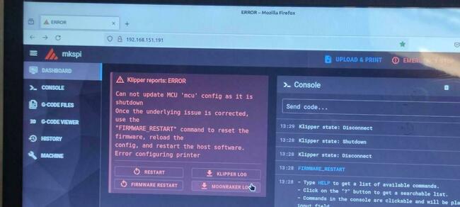

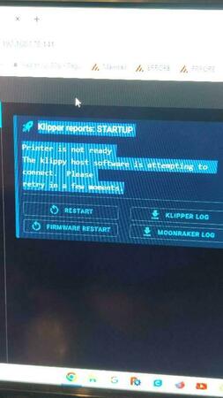

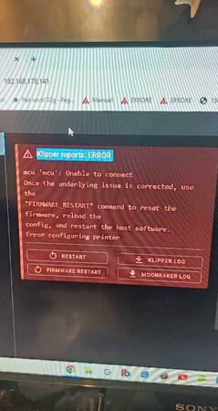

dove dovrebbe essere pr controllarli ? Arresto 'mcu' dell'MCU: ADC fuori portata Ciò si verifica generalmente quando la temperatura del riscaldatore supera è min_temp o max_temp configurato. Una volta corretto il problema di fondo, utilizzare il file Comando "FIRMWARE_RESTART" per ripristinare il firmware, ricaricare il file config e riavviare il software host. La stampante è spenta -

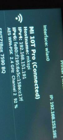

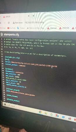

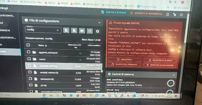

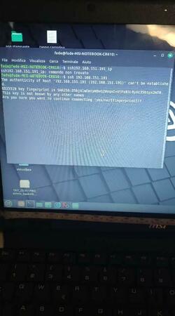

sul terminale del portatile scrivo ssh http://192.168.151.191.ip ? entro su printer.cfg da Killrob: non postare tutto il sorgente del printer.cfg, ti basta allegarlo e chi vuole se lo scarica e lo guarda 😉 mi da questo , come controllo? quali sono ? -

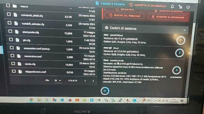

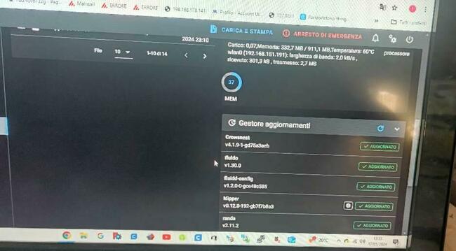

Adesso si ma non cambia, ora mainsail è collegato wifi ho anche provato a collegare portatile con pad via typeC accanto le USB della stampante ma nulla cambia -

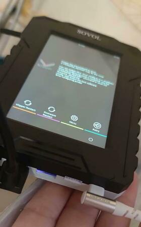

Dopo aver messo al posto /dev/ttyUSB0 mi dà questo su mainsail Quando lo ho generato con kiauh prima di fare il flash mi è comparso il messaggioche in foto Mainsail e pad . l'IP è questo ? -

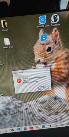

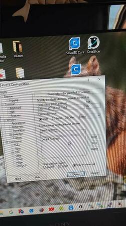

Non riesco a collegare putty al Pi tramite la rete hotspot del telefono . Ma mainsail si collega . Cosa sbaglio ? -

Ssh attraverso mainsail ? O posso usare kiauh sul portatile che ha klipper ,o putty sul PC ma non lo ho mai usato sul PC che ha Windows -

Provo e ti faccio sapere . Quando ho spento ieri sera era ancora rosso l'errore. A dopo -
