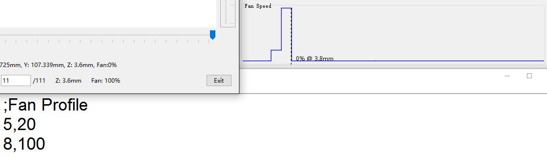

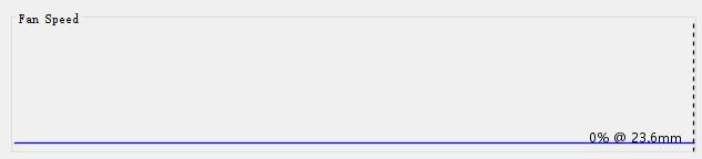

After test, I find this problem happen to Z-Suite v1.5 and previous version.
V.1.7.2.1 & V1.8 have a minor bug, the fan only last 3 layers, and drop to 0%.
This is V1.8.0 original fan, I'm not sure it's Z-Suite or Ztool problem.
V1.9&V1.10, haven't find any problem.
Hm, I'm not sure if any of this is a problem (of ZTool).
Let's try to answer in order:
  1. The fan is always 0% at startup (by definition), so it's not saved in the fan profile as it makes no sense to override.
    If you force a fixed 0% in Z-Suite, this might actually create a 0% fan command, but ZTool won't save it as it will only create entries when the value changes (and 0% to 0% means no change).
  2. Most versions of Z-Suite create a fixed 20% fan control after the raft even if you specify 0%. Has to do with raft separation I guess.
    Lately I observed fan commands inside the raft as well (at least for HIPS profiles).

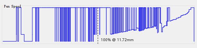

  3. In Z-Suite 1.8.x, Z-Suite introduced this weird 100% oscillations and I complained with screenshots like this (was still ZDump back then but anyway) in the official forum (search for "oscillation"). Actually these oscillations even happened with a fixed fan setting. Marcin argued this was by design to avoid pillowing. Later they admitted it was a bug at least for the fixed fan setting. My understanding is that they want to set the fan to 100% above horizontal surfaces but the algorithm freaks out on slopes. Anyway, not a ZTool issue. These jumps to 100% are really there. It's just that in reality, it's a relatively slow process as it happens from layer to layer.
    Also depends on the model and mainly happens on 90µm and 140µm settings with models that have slopes. But yes, this still exists in Z-Suite 1.10 (see attached screenshot)
